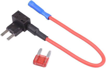

No, you can simply use a fuse jumper to piggyback off the 12v socket supply. It's fully removable and non-permanent. That's how I did mine (positive to fuse jumper, negative to a screw/bolt somewhere nearby to get a ground). Plug it into F40 on the fuse panel, you have two options; switched live (bottom position) or permanent live (upper position)
