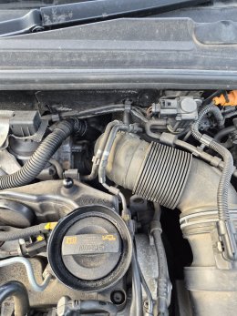

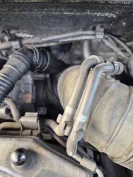

Really appreciate the response, it baffled me completely, it was obviously just overworked... hill, load and trying to overtake on a 138hp diesel..... a perfect storm, I just have no idea of what happened or why..... not quite sure how to test a turbo but i am going to service the car myself and look around from underneith the car because everything looks bone dry up top other than here..
