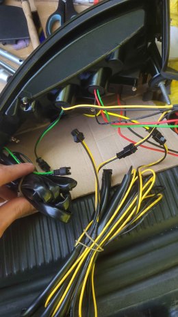

I did not dare to mess with the actual cabling / harness that is on the lights, though there are spare connectors Yellow/Black (feamle/male) & Green/Black (feamle/male) on both inner and outer housings.

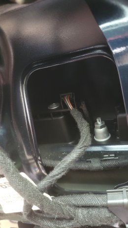

I have them on my pfl
On pfl you need to join the inner and out together to get the flow of the indicator
The loom also needs to be connected to both other rear lights.
You also don't need any coding.

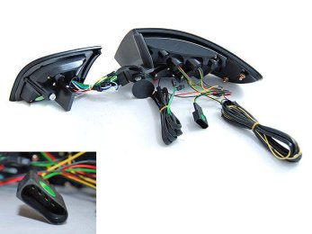

@LEE69 ,
Sorry to bother you about it, but the cable C, running to the grey cable of license plate harness.
Have you spliced the grey cable and solder the green C cables into it?
I have the inner to outer A and B cables routed and trying to figure out how to get the inner lights hooked up to the license plate.

No bother here to help
grey wire yes

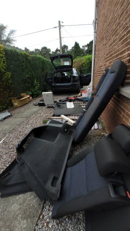

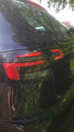

All done now, lights work perfectly!
Thank you for the intructions and guiadnce.
The site saying they are plug & play is a massive overstatement though, seeing as i had to pull out most of the rear interiour in order to route the cables properly through grommets.
Nevertheless it was 100% worth it.
