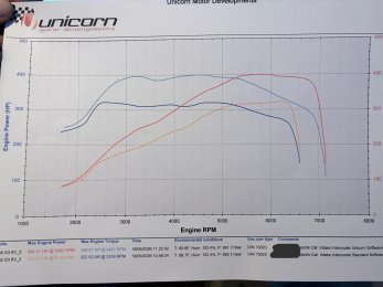

After picking the Car up in feb this year, I have just got to the end of fitting the required parts and getting the software updated to stage 2.
I sourced some parts secondhand to help keep costs down, and I self-fitted them all and serviced the car fully.
The parts list was :
Mountune intake
elbow and mulfler delete
Integrated engineering intercooler
NGK plugs
Racingline coil packs
BCS Downpipe with 200 cell cat
Mobil 1 0w/40
The Guys at Unicorn and BCS were awesome and helped with any questions i had and advise getting to this stage. I would highly recommend them to anyone needing their services
I ended up 399bhp and 399ftlb , car feels good and im looking forward to giving it a good drive soon and see how it compares to my old 2014 S4 ,stage 2.
It made good power to start with, which i was surprised to see as it is a Jap import.
