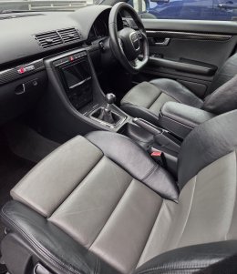

Here's a pic, its not the one I'm getting but its the colour etc , just a taster for you. :icon thumright:
not the best pic angle for an Rs4 but hey it still looks good.

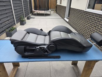

Okay took the seats off for a deep clean and condition.
No green connector, so I guess no heated seats!
37370
37369
you will need a loom for heated seats then plus the climate control unit if you want heated seats.
kufatec do the heated seat looms , and pickup a climate control unit from the classifieds.
wheather its worth the hassle all depends on you chap.
I had them in my B7 and used them twice in 12 years .
Ive just picked up a complete full electic set for my allroad as it had basic adjustment seats, albeit with top spec covering.
Same situation, my allroad is missing the looms for powering the seats and heating.
Not fussed on heating and it's one less complication to overcome, but getting power is very straightforward.
You're right Rob, I probably never use it and seems far too much of a hassle, I'll just clean the seats tomorrow and stick it back on.
