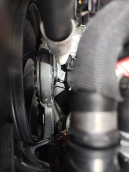

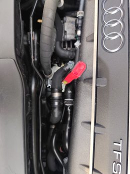

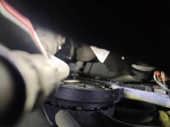

2019 rs3..... checked the oil filter , that's dry , as I can see from the top , there's some oil on the tray , no idea where it's coming from ,back of the sump bolts looked a bit wet with oil nothing bad , but this oil is at the front...any idea?

I had this once after a service from Audi lol, when the oil filter is replaced the drain off Nipple needs resetting by gently pulling it back out.
I wouldn't worry though as oil pressure itself will push the nipple back out and reseal the drain off point.
Reactions: vw754
It was previous oil that had soaked into the wiring all good now thanks
