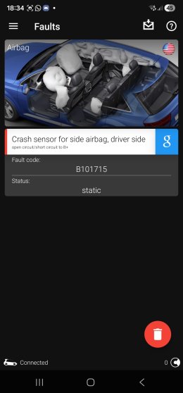

Hi thanks yeah I'm gonna have a look under the seat, but the error code, pic attached, does specify side airbag, so would that still be the sensor under the seat?

Ah ok, then have you belled out the wiring, cause the airbag module is a fecker to get too, chances are it's door wiring either in the door or in the plug, often wiring is broken in the hinge & you may not see it initially, stick a meter on it mate & see if continuity pings ok.
