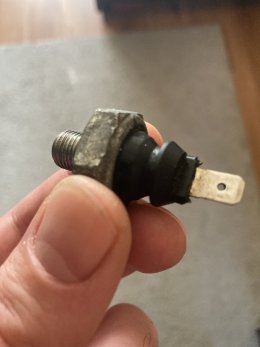

Hi. I cant find the oil pressure switch oem number. Looking at the diagram but there is not listed. If i searching on google i find couple but they look different. I just removed mine, here is the picture. 1.2-1.6 bar. Is it the correct oil switch or somebody installed the wrong one? Thank you.

068919081D Black Oil Pressure Switch 1.4bar M10 It may be this one there are 6 variants I will look what engine please remind me? https://www.lllparts.co.uk/product/068919081d/oil-pressure-switch-068919081d You will find it here

please see my previous message your answers are there as you did not state your engine in the headline
AMK comes back with two part numbers
06A 919 081 D and​
06A 919 081 A both 1.2 to 1.6 bar and yours looks like the D version all the best problem now solved hopefully @MPH
Reactions: Method
06A 919 081 D and​
Thank you, but i cant find a one pin version for this part number.
https://webautocats.com/en-gb/etka/audi/a3/209/919040 got my information from here, maybe yours has had the plug changed, my agn has the above number also listed for amk that one should be fine at 1,4 bar 068919081D so go for this one
Thank you very much for your help. I find a first 068919081D number, 1.2-1.6 bar, they used in the old quattro. That should be right too if im right? Yeah i think that too, maybe somebody broke it before and replace it with this one.
