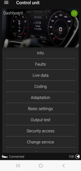

  • In OBD11 app enter your Dashboard module
    • Navigate to Adaptations

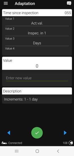

  • Open Channel 055
    • Same as channel 055 except it counts days
    • Change value to 0
