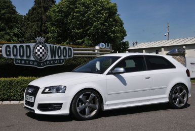

It was running EAGLE F1 ASYMMETRIC but i changed to Falken last time in case it was the Asymmetric bit causing the problem.
The change did make it pretty awful but it calmed down after a few 100 miles. Its only now that i have twigged it could be the wheels hanging on the lift as its gone this time without the front wheels being touched, just lifted and put back down.
yes i does have spacers 10mm front 12mm back but i took them off and it didnt make any difference.
