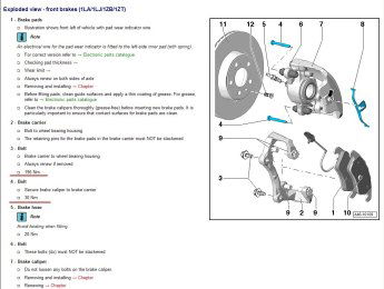

I did this job on my 8V back in 2022 and I had two sources for the torque - 196Nm and 200Nm (see pic).
They are definitely 'stretch bolts so should be replaced each time. Once they yield after tightening if you refit them there's a danger they may snap with such a high torque for a second time.
I think you'll be fine at 175Nm it's pretty damn tight.
