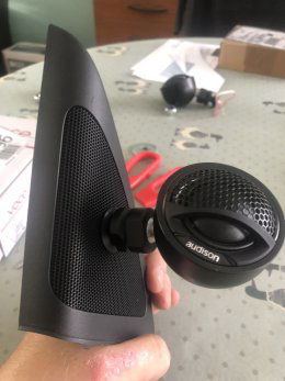

Would like to see some pictures of the tweeters and where you mounted them
I bought a set a standard tweeter covers and then mounted these billet pods to them and reinforced the rear of the mount . The pods are full adjustable so can be angled properly unlike the stock location
