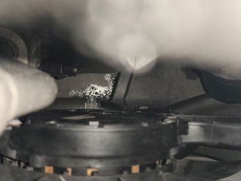

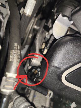

Cap was clean before I set off today , drove round trip of around 130-140 miles , checked oil cap , all good , nice and clean , smelt coolant , checked under the bonnet and noticed these 2 if any has an idea , pipe that I've circled was wet , and at the bottom of the rad , just below the pipe...damp patch.

looks like you got a leaking radiator... I'd replace it asap, because if left it'll get worse a lot quicker than you'd expect. refrain from using a stop leak solution... it can make matters worse ( like blocking the interior heater matrix's core)
Will double check it's the rad and not the pipe , cars got extended warranty anyway

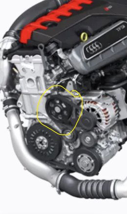

Check around this pulley for the water pump.
It can leave evidence if weeping
