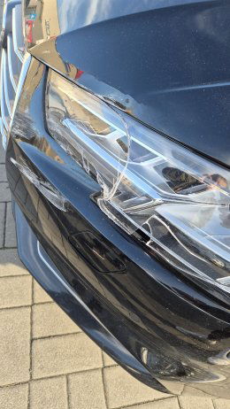

It is only the cover that is damaged, the light still works, would it be wise to only get the covers replaced? As they are not as easily accessible i would think that any moisture inside will damage the lamp in the long run and it will not be easy to repair.

Jup, in that case, you just replace the lens... if you can find it on aliexpress or similar. That said, how OP described the problem it sounded like the insides were damaged. This is clearly not the case.
