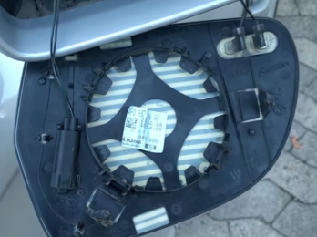

I need a mirror glass for my A3 8P S-Line, ive looked on eBay and it says heated ones but doesn't look the same on the rear as mine as it has power connections either side, where would be best place to get a replacement? Screenshot 2025 11 30 at 085607
What’s the reg or vin I can get you the part number to look for
It might also be on the sticker in the middle.
Yours is heated only as although it has a dimming glass wring from the base, it doesn't show the other connector for the dimming & it's just the connector has been put onto the mirror location but isn't plugged into anything.
ACC822A- REG
4F0857535AH - Left
4F0857536AH - Right
Your VIN has the PR code
Exterior mirror adjustment
6XK
Exterior mirrors, auto-dimming,power-folding/adjustable/heated
I guess if you don’t want/need the dimming feature you can fit a normal heated only glass.

so just those heated only off eBay will fit it and work as normal?
I fitted a non dimming, heated only glass last year and it's been fine.
IIRC I contacted Stoke Audi and the cost of the OEM glass was some insane price like £295 + VAT
Cheers for that just ordered one off eBay....I got the same quote off Sheffield Audi....absolutely ridiculous.......
