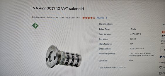

I replaced these parts and the car is still doing it. After speaking to him again he was adamant that it was a timing issue and the only other one it could be was a 'Oil control valve' part number '427003710' which according to him sits at the end of the cam where the cam magnet pushes onto. It comes with 2 holes to screw on with a special tool. Does anyone know if this can be replaced without replacing the timing belt?
The cost is adding up and I can't afford to keep guessing. I don't mind paying the money as long as it fixes the issue as I love the car and intend to keep hold of it.
