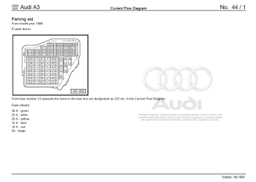

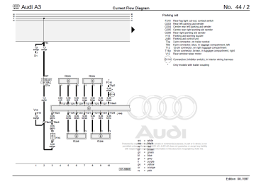

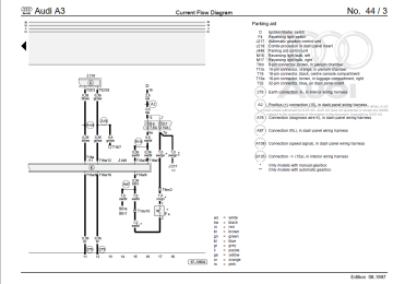

Hi all.
Just installed the bumper insert with sensors, parking control module and buzzer. does anyone know how to wire it up? Got 5 wires I'm not sure off coming out the loom from the control module:
Blue/red
Grey/white
Blue/white
Black/blue
Black/blue.
If it's OEM or Kufatec, this should be helpful. All the best @MPH
  • PARKING AID.pdf
It's OEM, thank you. Will try and get my head around it
