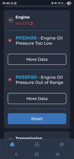

Hello all,
Looking for some help/advice please?
So I bought this car May 24 with 90k miles full audi service history. I'm a private hire driver and its now on 166k no issues apart from common Adblue fault which has been mapped out and replaced a clogged EGR valve. My problem is low oil pressure warning has been coming on consistently for a while now. I've had an oil change and oil filter, new oil pressure sensor, oil pressure regulator all to no avail still getting the fault code. I know your not supposed to drive it all with this warning unfortunately that is not possible in my job? There are no obvious signs of anything majorly wrong, overheating, knocking noises, burning smells. The fault seems to trigger when the car is at temperature 90 - 100°c but is completely random after that. My mechanic is going to check the pressure with a mechanical gauge to see what is going on before I shell out for a new oil pump when it might not need one?
This has been going on for weeks now and is driving me mad.
Any help or advice would be greatly appreciated.
Chris

Needs live data on VCDS, that will show oil temperature, pressure. When the car was scanned - what DTCs were logged?

Sorry, what are DTCs?
DTC's in attached file, thanks.

Yeah it is a diesel and we have already dropped the sump and cleaned it all, new gasket and oil strainer/pickup was fine??? Yes I'm so worried that my car is going to blow itself to pieces at any moment although nothing unusual is happening and I've easily done over 2000 miles with this issue now??

So it looks like it was actually an issue with the DPF!! Occasionally it was giving the fault code P2002 DPF filter (bank1) is not working efficiently! Apparently the car will add extra fuel to raise the exhaust temperatures if the DPF is not working properly and regeneration isn't clearing all the crap out and some of the fuel can end up in the oil and dilute it too much triggering the low oil pressure!!! Its all been cleaned out and have done over 400miles since trouble free and no fault codes. So its all this euro emissions crap that tries to kill your engine!!!! Hopefully it's sorted now anyway . Thank you all for the advice and help, very much appreciated!
