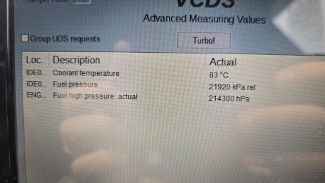

Have a 2008 2.0 TDI common rail.
Had an issue lately that the car has stalled when I stop at a junction, usually coming from 3rd. When it did stall I got the check light and got p0087 low pressure in fuel rail. Cycling the power cleared it. Car drives perfectly,no smoke ect. Changed the fuel filter and no difference. Took the fuel regulator off today and spotless, no swarf. Where would go next.
Also once in a while it has had a rough idle.
Was told check fuel pump...am I right in saying there is a tank pump as well and the inline pump at the filter ?
What one would you change first.
