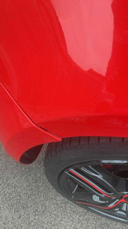

Can anyone ID the proper clips that stop the edges of rear bumper sticking out?
Had it painted & they've not put originals back on after!

2013 3 door.
Can't see it being a bolt, there's a U shape cut in arch liner & a slot in bumper. Nowhere for anything to screw in to.
Both sides are missing so nothing to compare?
think its #20 on the diagram what you're looking for going by your description
8X0807151A
8X0807152A
£21.20+VAT each retail from your local dealer
google the part numbers you will see the picture
