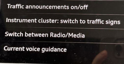

I have the steering wheel button configured to disable the speed warning on my face lift S3.
Perhaps it is software or model dependent.
How odd, mine are totally different:
IMG 1534
There is also a further "Current voice guidance" option if I scroll down.
My software version is 4143.
I get the below as further options.
My car is a vorsprung and looks to be running software version 4318.
This is what I saw in that test drive car and expect to have in my next car too. The other pic is indeed confusing, it shows like the pre-FL star button options.
Was the car you test drove a Vorsprung or Black Edition (or something else)? I know the Black Edition has a different steering wheel so wonder if that's why the buttons and software versions are different.
We have very different trim line policy here, it's more like in Germany but without the most stripped basic variants. The test drive car was the most basic we have. I think the buttons in the steering wheels are exactly the same regardless of the design.
