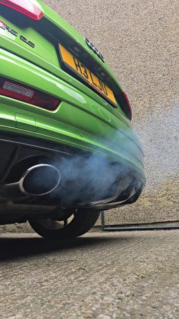

I hope people don't mind me posting this here as I have a 2016 RSQ3, but the problem is relevant to the 8P RS3.
The car has been using oil, not a lot, but over the last couple of years it's been significant enough to cause concern.
I did notice recently that it smokes a little on cold startup for a few seconds, and also after being left for a while once warm. Once that clears through afaik it doesn't do it. My first thought is valve stem oil seals.
20250531 1250175
I did have a leak under the turbo inlet that was looked at by Bradford Audi last year and although improved, it is still there slightly. Im not sure if this is related.
20240330 162646
I also recently replaced the pcv valve on top of the cam cover and on inspection it did have a small split in the diagram....bingo I thought, but it still does it
1000019805
I have done a compression test on the cylinders and they are all within 5psi of each other and strong (200-205psi) so I don't think its rings.
The car does occasionally feel very slightly lumpy on tickover but other than that it drives really nice and pulls well.
The car is APR stage 1 (done 2 years ago) and has 44k on the clock.
Anyone have any ideas of where to look?

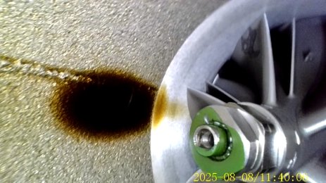

Thanks for the reply.
I did wonder if the turbo was worth a look, would that lead to oil collecting in the pipe and giving that puff of blue on startup?
It's never been abused (or at least in the last 5 years) and it's had oil changes every 4-5k
Should there be a small amount in the inlet pipe?
Also would the turbo tie in with the oil leak around the inlet. It was quite bad before they "fixed" it!

Yes, if oil is leaking into the turbo, it can pool in the inlet (via the intercooler) or in the exhaust, sometimes both. I would check the turbo for play and the intercooler pipe or turbo outlet for oil.

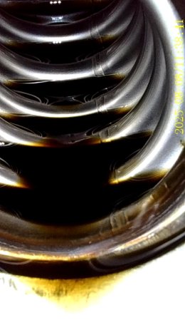

Ok so I had chance to get under the car today and remove the turbo pipe.
The pipe was fine, nothing to see. However both the rubber pipes at each end of the intercooler pipe did have a fair bit of oil sat in there.
1000020809
1000020808
1000020810
1000020815
I called in at the place that did the map 2 years ago and he recommended an oil flush and change, and to send a sample of oil off for analysis so I've ordered that
