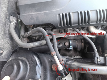

ugh no.. It gets very very hot.. The online app is pretty decent. but now my issue is identifying & tracing the brake lines back to the master cylinder.. all of which on that side likeley need to be replaced :( thats not something i can aford to have done.. the goal now is to find a decent brake line diagram. i cant seem to pull one from the app tho. And would you know what these 2 lines are?

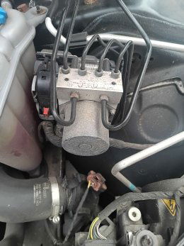

(edit) It seems everything else is good. i managed to calm down and trace the brake line. seems i was having some kind of momment that obscured OBVIOUS details.. But my next 2 suspects are the abs pump/ motor thingy and the master cylinder.. the other 3 wheels are fine.. this side just doesnt ant to retract. its not "stuck".. i can push it back with little effort.. i think its this abs thing, maybe?

Look like the fuel lines... the one that gets hot is the return line. I-d put a jubilee clip on that loose one because the last thing you want is that popping off.
Reactions: DocEllis
So that loose plastic thing would be its disconnect sleeve tool? I want to push it in, but i think thats how you would take it off?
It should have a securing clip in it check it as I don't have a diesel to check it right now... it's Saturday, my mates are all out.

Im stuck in a sort of "cyclic redundancy check failure"... Im pretty sure ive isolated the issue to either the master cylinder and/ or? brake booster and/ or the abs control unit.. If the booster had a vaccum leak that would explain the sligth pedal sink, i think. But so would bad seals in the master cylinder.. but those 2 cant be the entire issue because only 1 wheel seems to be SERIOUSLY malfunctioning.. that points to the abs unit, but still doesnt explain my pedal sink with no fluid loss.. so im stuck trying to reason with myself if its the booster, master cyliner or both.. i would rather not have to replace both. but that elsewould be doing that?. but without doing a vaccum check on the booster, is there any other way to test this?
Might be air stuck in the ABS unit... i'd take the car to have the brakefluid replaced before doing anything else... yes i'd pay for it as when the ABS unit has air trapped to get it out the best way is to use one of those professional bleeding machines... VCDS does have an option for this too but it's way harder without a professional system as that can completly flush the brakesluid systerm without the need for using diagnostic bleeding for the ABS unit.
