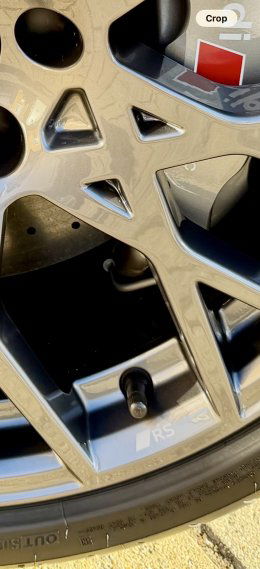

On my 2022 8Y I had the proper TPMS with wheel sensors, I'm sure the carbon/ vorspung didn't and Audi had gone back to using ABS ring indirect method
Way to tell is the tyre valve looks different, mine had a silver wider bodied valve.
Also you won't have the option to view the pressures / temps in the VC or the MMI.
