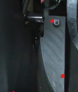

As an alternative there are two nuts on the brake booster connecting rod that I need to get at but its almost impossible due to bad access so was looking to remove the dead pedal to give me some more room. I've removed two bolts from the dead pedal but still cant remove it , tried pushing and pulling it in every direction and no joy.
Are there any more bolts to be removed from the dead pedal other than those shown with red dots in below image ? what is the method to get the dead pedal out ?
