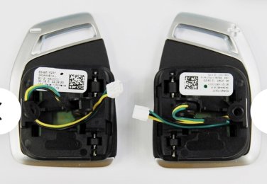

Anyone know / confirm if the shift paddles fitment is same between the Rs3 8Y and Golf mk8.5 ?
Golf R has far better sized paddles.

Thanks but that doesn’t tell me anything. All the cheap paddles are magnetic / stick on extensions. Not looking for aftermarket as they look gash. Need to know if the OEM ones fit including the wiring connections.

if the airbags are the same size you could simply swap the wheels... i get it it will be a lot cheaper to just swap the paddles inside the steeringwheel...only one way to make sure.. part number comparison..
Managed to get part numbers from ETKA and do a reverse search. Also an online video showing the install on a GTI.
Looks like only a viable swap for VW models but not AUDI.
Price online for these is £107 which is great value……..if they fitted

Thanks. VW airbag is different shape and sure other connections likely different. Not wanting that much hassle either. Looks like the only paddles that fit with slight modification is the ones from the URUS. However, they are silly expensive and I really don’t like the fussy design. The VW ones look great hence why I thought they may be an option.
