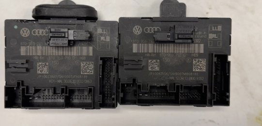

Hi thanks for your help my bad the part numbers I wrote wrong they are
8T0959792G, 8T0959793D
Yes both fine. Easy to tell if they are highline as the boxes in the top right are fully coloured in.
