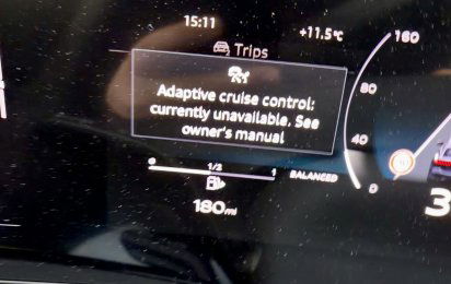

EML still on and I have deduced it’s the rear offside door that needs to be opened to get the cruise control working !
I can confirm that I too have to open the rear offside door to get it to work again. I will be refraining from opening that door from now on and just leaving it. I am too finding Audi Uk stalling on this as well. I've been pushed back to the dealer again by Audi Uk and till March. By then the car will be 1yr old and I wont be able to reject it or it will be harder. I am not gelling with this car at the moment.. When it works brilliant..

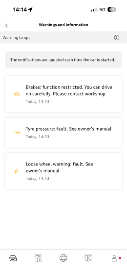

Alarm went off on Sunday twice for no reason and it would not respond to my key fobs. Boot would not fully open.
The pre sense has got a mind of it own, it jammed the breaks on twice yesterday and there was no one in front of me or anybody.

I managed to break the cruise control again today. That's twice now. I sometimes accelerate just using that stalk and not the pedal. After a while it kills the cruise control. A simple reboot fixes it.

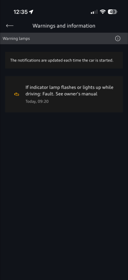

Came up twice. After I restarted the car. I took a picture then went off.
Other think I have noticed is MPG is horrific
Just managed to get 260 miles to my last tank of fuel. I swear this is the reason for the engine light keep coming on.
