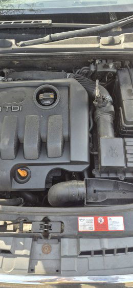

I've recently purchased a 2008 P8 Sportback and gradually going to fix the bits and bobs that have snapped, broken etc. over it's lifetime.
Just spotted there is a cover missing in the engine bay. Bottom right in picture.
Any idea what's missing and where I can buy a replacement? Pert no. etc.
It's a trim to cover the air duct so it directs air into the air box.
eBay or maybe ask Audi.
Reactions: NortonCanes
1K0805965J - £6+VAT retail from your local dealer
