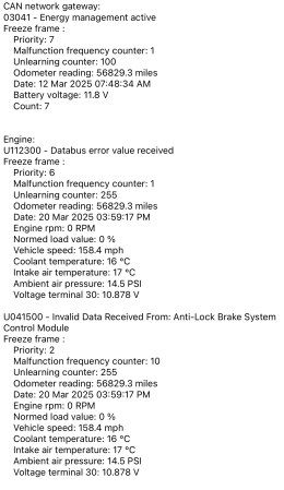

Started S5 2015 after being away for 2 weeks, dash lit up ABS TPMS ESC etc etc all lit up. Have attached faults recorded from basic OBD scan. Seems to show an incorrect reading from sensor 158mph.. could battery issue cause this?

I'd definitely recharge and check the battery health before doing anything else, then obviously drive it and clear all stored faults.

I’ve driven it around a fair bit still can’t reset and is showing rear right sensor is at fault
