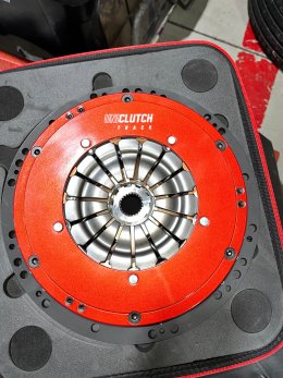

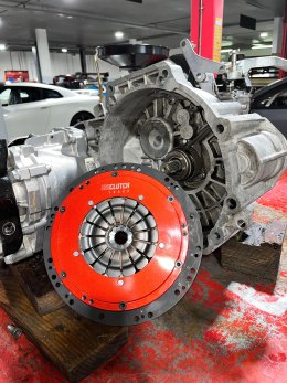

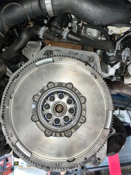

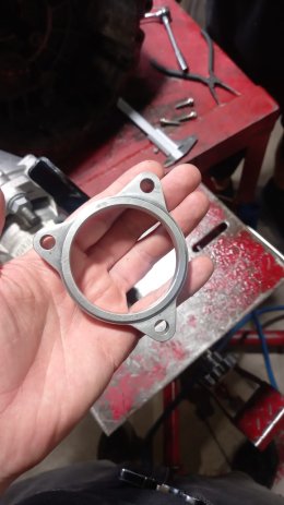

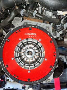

Save yourself a lot of trouble and change the clutch with a UniClutch while you have the gearbox out to replace the concentric slave cylinder. My Concentric slave cylinder decided it would only release halfway and fried my Sachs Performance clutch. I decided to just go with a UniClutch Track. You also don't necessarily have to replace the flywheel, but in this case I had no choice, as my flywheel was completely fried too. There are a couple of gotchas though. you need to add a CSC spacer and a spacer between the gearbox bellhousing and the engine. The UniClutch has better feel than the OEM and Sachs Performance and the pedal is ofter too.
UniClutch 3

Thanks, that’s great info. Does the spacer come as part of a kit or is it a special order. Mine goes in next week!
Unfortunately, it's a special order. :unhappy: The plus side is that UniClutch should know about this and should have all the measurements to cut the CSC spacer and the spacer between the bell housing and the engine.
