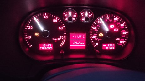

to check if your speedo is calibrated correctly do an output test in vcds and the rpm needle should land on 3k rpm when staged and the speedo on 100km/h and both temp and fuel gauges at 90 and half tank respectively
OK, manaaged to get around and do the test. This is what i see. I make it dead on 65mph so slightly higher than the 100km/h.
Is this adjustable to read precisly 100 ?
