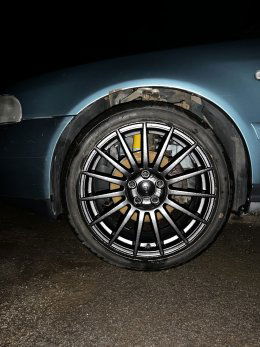

I did 345mm S4 fronts and 300mm rears with FL S4 calipers and adaptor brackets on my B5 TQS which fitted under the 8J ET35 Boleros.
IMG 9749

I did 345mm S4 fronts and 300mm rears with FL S4 calipers and adaptor brackets on my B5 TQS which fitted under the 8J ET35 Boleros.View attachment 279953
