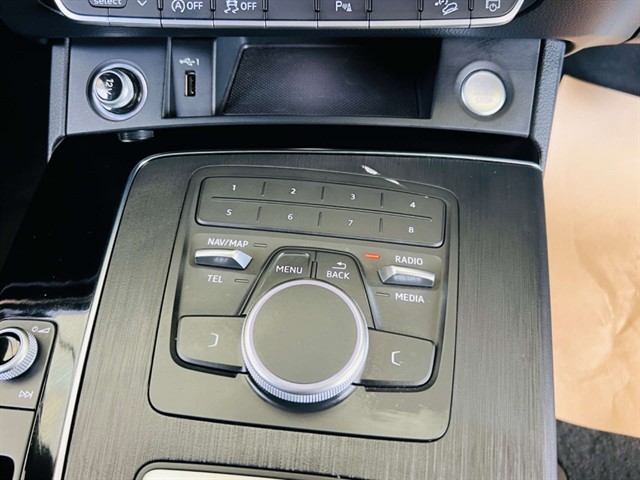

When you are next in the vehicle, after turning on and allowing the media system to boot, select and hold NAV, and while still holing NAV select and hold MEDIA. After a few seconds the media systems update menu will display. navigate to activation keys. These are a list of your media system licences. All will show as 000XXXXX (where X = a number and or letter) bar one which will display as 0XXXXXXX. Post this digit string here and we can tell you what you are licensed to use.

this is the set up we have (online pic) yet by holding the nav button down and the media button up for about 30 seconds didn't give me access any advice..?
