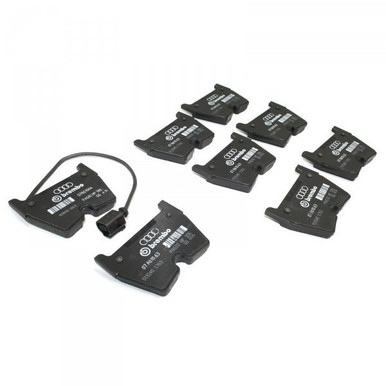

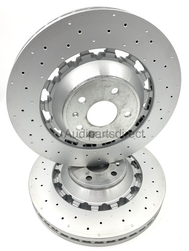

Are these the correct OEM discs and pads for a 2018 FL Sportback RS3...
I've had a look on Audi Parts Direct at what appear to be the same ones, and they're £1000 more...

Have you put your reg in the search by reg no. box?
I have a 67 Daza Sportback and it says they're not compatible.
I believe these will fit.
Yeah it says it's compatible with my 2018 DAZA sportback. Strange.
Saloon discs are different, places like Autodoc don't always differentiate. Brembo website is correct for their stuff just go off the Brembo part number not the Audi one

Front pads there are 2 types from Brembo
P85 152
P85 152x
Rear
P85 162
Both available from Auto doc by myself and they fit 100%. Mine is a 2017 Sportback (DAZA)

Discs (front):
Hatchback needs the 09.D174.33
Saloon needs the 09.D174.53
Pads (front):
P85 152 - These will fit and are normal pads
P85 152x - These are better performing pads for performance cars and also come with a wear sensor.
I recently used the 09.D174.33 + P85 152x for my fronts. Work great. I have a RS3 2018 8v Sportback/Hatchback (DAZA).
