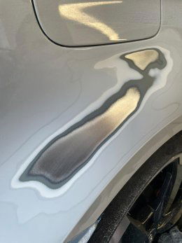

3. The paint, I has some small clear coat defects on the paint where its peeled, about 20 pence piece sized on the roof spoiler and perhaps 3 pound coins in size on the side of the rear bumper. I think its a serious paint defect not wear and tear. I have put this to the Audi dealership as I asked for a video showing paint condition and it wasn't picked up then, it also had the Autoglym lifeshine service in the prep for the car and no one flagged it then either. I think hopefully it can be spot repaired by a good body shop I cant imagine there is a need for any additional paint etc.

2. Likely the famous wastegate rattle, the car cold starts with the wastegate open and the 'penny' on the valve rattles in the breeze. Annoying for some but perfectly normal and does no harm. Worse of you have an aftermarket downpipe on but can be reduced with a re-map if needed.
3. For any paint defects I would check (or get checked) paint thickness as these things can stem from spot repairs from dings during delivery. Easy to tell if paint is original by the thickness.

good shout on the paint thickness checks, I have looked at the paint in all sorts of light and if it has been re-painted then the colour match is really good I cannot tell which is quite rare!

Is it reasonable to ask for a hefty contribution to repair rear bumper & roof spoiler after purchasing this car? I wouldn't consider clear coat peel to be wear and tear but I am fearing that they will and leave me with no choice but to accept it or return the car.
I would speak to the dealership to ask why the paintwork defects were not flagged up to you, in the paintwork condition video you were sent..?
I agree with you that clear coat peeling is NOT wear & tear, and should’ve been flagged up on their 174 point visual check ..? Sorry to ask the obvious.. I guess you never noticed this on the vehicle handover. Was the car in the collection bay inside or outside in the car park.?
I consider Aberdeen Audi should be onboard to be helping you for sure, as a goodwill gesture. As for handing the car back….. Looking from the photos it appears a nice example, and as others will agree nice examples are getting harder to find. And being that exclusive colour, you’ll be waiting ages to find another.
Keep the conversation open with them and see how it goes..? One thing I did notice, buying a car from the Aberdeen area, was brake lines were corroded badly even on a 8000 mile car.. So keep an eye on that., Hoping you can arrive at a agreeable outcome as it looks a nice example. Keep us informed..
Hi,
No I specifically asked for a video showing paint defects and these bits wernt shown. When I collected the car it was 3:30pm, dusk and outside in the car park.
I'd like to think they will be willing to pay 75% of costs to repair and I plan on getting them a few quotes and emailing them over requesting 100% contribution to start with.

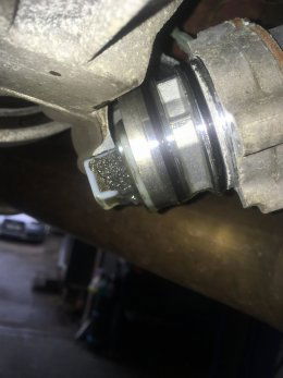

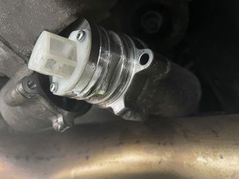

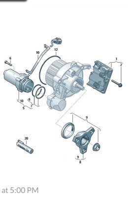

I suspect it is a Haldex pump issue.
Audi dealers do not service the haldex properly, the 'fluid change' does not take the pump out to check the gauze on the pump, when that blocks it can knacker the pump. While you are at it change the oil front and rear diffs. Front diff on the 8Y is a now 20k service, same part.

I would INSIST that the Haldex gauze is properly cleaned, the garage will be able to provide you with a short vid as proof.
Mike
Some dealerships do the Haldex Pump change correctly if you stress you want the gauze/ filter cleaned also..
That is the first I have heard of it being done. I would not expect it to have been done on any Audi dealer serviced car I was buying or bought.
Two dealers near me flatly refused to do it saying it was not in the official haldex service procedure. One said I had to accept responsibility for any future damage if I insisted, and this was after an oil inspection proved they had not even changed the oil the previous year.

I do suspect the gauze is either blocked or has been partially blocked for so long that flow rates aren't high enough for the quattro system to work properly or that the pump has completely failed. Either way I think if the gauze is blocked I'll push for pump replacement because it shouldn't run dry or partially dry that would do damage.
Regarding the paint issues I had a call from the salesman I dealt with during purchasing and although no progress yer he admits he must of missed it and said he will talk to his manager tomorrow about how best to resolve it which sounds positive for now.

How easy is it to gain access to the Haldex pump under the car? I am tempted to remove it and inspect the gauze myself.
Does the car have to re-learn the pump after removal over VCDS?
Booked in at Audi on 27th Jan but that's ages away.

I'd be incredibly surprised if the haldex pump was gummed up enough in 20k miles to cause TC issues.
I think it's far more likely that the famously awful P Zero tyres in the cold aren't gripping up. I'd be swapping to Michelins personally. Or just throwing a haldex pump at it.

I mean 20k but also coming up 7 years old.
It isn't a tyre issue I am so sure, they are like new front and rears, the right spec, the right pressures. I am getting the TC light without any wheelspin, it just feels like the all wheel drive isn't working properly whilst I am driving.

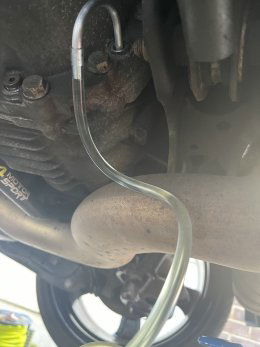

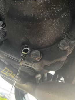

Haldex pump should also be primed once the fluid is changed, I’d like to think Audi techs know this and do it as a matter of course.
Have you access to a scan tool of any type (VCDS / OBD11)? This can tell you if something is amiss
I do know there was a traction control update that addressed the wheel spin certain owners reported.
Reactions: GarnetRedRS3
This was mine at 15k. Clean as a whistle.
If it's spinning up the fronts and no rear engagement then there is an issue with the Haldex somewhere, a laptop and diagnostic software will help here.

This was a car I did a service on for a friend.
Note the gunk build up on the gauze filter.

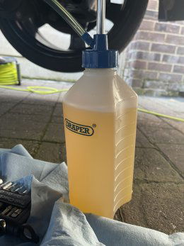

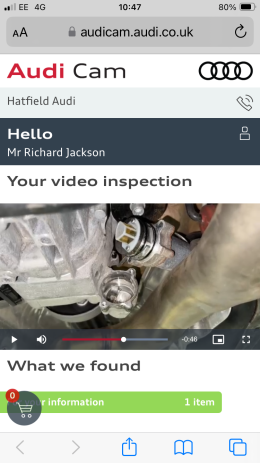

Wouldn't be surprised at all, especially given the colour of my oil @ not much over 20k, Gen V Haldex can be hard on the plates and no filter like Gen IV . I agree with you on the Michelins though.:icon thumright:

Pick your bodyshop wisely is my advice.
I went down the rabbit hole of having a paint issue rectified that Audi main dealer said wasn’t a defect.
Turns out these brown spots were something in the primer coat that took their time to start showing up on the white face (3 years)

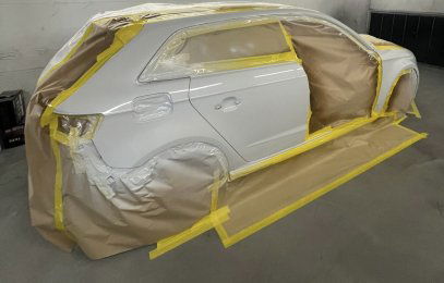

Still trying to make headway on the paint issue.
