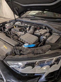

IMG 8330
Reactions: JKP
You mean your 8Y A3 too? Go check, mine doesn't and I can imagine it could be one of those nordic equipment pieces not necessarily put on cars for another territories. We have conditions where you have to use the windscreen wash a lot, at worst it's like you have to refill during a 400 km trip even though you did that before getting to go.

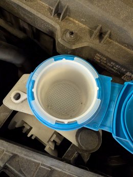

Yup, mine has the filter, knew I wasn't imagining it! The A3 was ordered in Dec 2020, received it July 2021. Maybe it was before the parts shortage? Had the joys of SOS ping and software gremlins! Though I'm pretty sure it's the same part(s) from the VAG supplies as look identical filler thing wise to my previous Seats. I 'thought' I had the headlight washers as I have the heated seats, and I can see the caps under the headlights but apparently back when I ordered, only matrix LEDs had them.

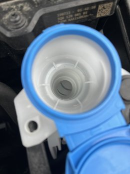

Reactions: JKP and Simon50s
Interesting to see that. Surely there's a reason why they are left off from the newer cars but it's very hard to see it, considering the amount of plastic parts there are just to throw away in the delivery service. The filter looks like it costs like 0,02 € to Audi and shouldn't be hard to get either.
I see some sand grains on the bottom of it already. I think I'm always using the kind of equipment to refill the fluid tank that it shouldn't be likely to get dirt into the tank but you never know. Maybe I should try to find me a filter....

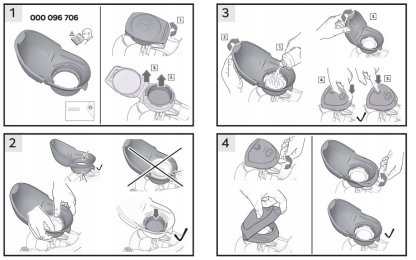

@JKP I've some more information about those funnels - the devil is in the detail LOL.
This is another one of those small things which I barely gave a second thought before my new car.
Firstly, I've just realised the reason the blue VAG silicon funnel didn't fit. I found some instructions (see photo) which shows that you're meant to remove the existing windscreen washer cap first . I didn't realise the silicon version was actually a replacement which also acts as a closure cap :blush:. I just thought you use it each time for filling. So I was wrong to dismiss this. The one I purchased didn't come with any instructions so I just made a wrong assumption - user error LOL.
Screenshot 4 3 2025 105224 wwwmotonetfi
VAG OE-6V0955485 or 6V0955485A
5064

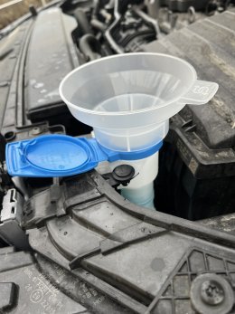

I bought and fitted the funnel type cap today. No problems, the old one got off just by pulling and the new one by pressing enough. Feels quite handy but you must not pour too fast... Better than without but not as good as a real funnel.
