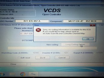

Hi.
I am unable to access the Bits in my 5F. Whenever I try the long coding helper I get this. What could be causing this?
the program does not have a file to reference so do as it suggests and send rosstech an autoscan and a controller channel map
Reactions: NHN
If you have genuine VCDS then select yes to experimental coding when asked and it will load raw data. What are you trying to do?
Still just trying to finish my B&O retrofit. I just fitted my MOST splitter for the amp/virtual cockpit. I just want to see if I can get any indication that the car sees the B&O
so now you will need to complete long coding and adaptation changes in your 5F, plus parameters. Can use LCode2 to manually code if you know the bytes and bits to change. Parameters cannot be completed with VCDS.
