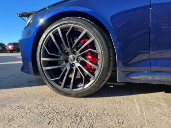

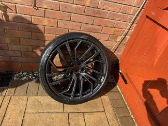

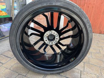

I'm actually not a big fan of the wheel colour or design. I feel black wheels lose all the detail and like you say, get dirty immediately after washing. I thought about doing a colour change (Anthracite/gun metal) or change wheels but I'm undecided on whether I will keep this car long term. Maybe the black will grow on me now they shouldn't be so bad to keep clean.
There's a video here where the wheels look like as you describe. I agree, I think they look better than the black.

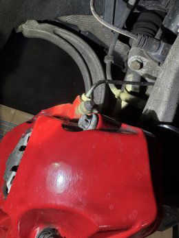

Replaced the rear pads this evening, they’re super easy to change. Took an hour all in.
Things you need
  • Brembo HP2 (07.B315.74) pads
  • 13mm socket
  • 17mm spanner
  • VCDS or equivalent to release the parking brake
  • G glamp or equivalent to push the piston back
  • Loctite
  • New rear wear sensor
The process
  1. Make sure the car is flat and chock the wheels. It won’t go anywhere as it will be in Park but better to be safe
  2. I used VCDS to put the parking brake into service mode. Take the parking brake OFF or the next bit will fail. Go into module 03 > basic functions > start brake lining replacement > Go!
  3. Turn the ignition off
  4. Remove wheel
  5. Hold the inner nut with a 17mm spanner, remove the rear 13mm bolt (repeat for the lower bolt) and slide the caliper off the disc, the pads will remain in the carrier, lever them out with a screwdriver
  6. The caliper piston pushes back so I used a G clamp as I did with the fronts. Be careful not to put too much force and crack the motor housing on the back of the caliper as it’s only plastic.
  7. My old pads had a clip which fit into a recess on the carrier (see pic where I’ve loosened them). I removed them by putting a screwdriver in the bottom and twisting it. The new pads had spring clips attached to them so the original clip was redundant. The caliper actually looks the same as the one my S3 but bigger.
  8. There is only one rear wear sensor and it’s on the drivers side. Mine snapped when I took it off so good job I had a new one. Pay attention to the inner pad as it has a cutout for the wear sensor and the outer one doesn’t. The wear sensor only fits to the pad one way and I spent longer than I care to admit working this out!
  9. Installation is the reverse. The 13mm bolt should be 30nm but I didn’t have a torque wrench that goes this low so I went with “gutentight” . Remember to apply loctite to the thread.
  10. Once the wheels are back on, go into module 03 > basic functions > stop brake lining replacement > Go! You will hear the caliper adjust itself. Check the parking brake works as it should.
Initial verdict
I bed them in by doing a few 60-20mph runs without activating ABS and let them cool in between the runs.
It’s still early days but the pads are much quieter! So far, no squeal at all. It was noticably quieter with just the fronts replaced but better to have the same pad compound all round for predictability. Even when braking at a slow speed I got a slight grinding noise with the OEM pads, this is gone now. It will be interesting to see how it is in a few weeks after a few short journeys to see if the squeal comes back, but the initial signs seem promising.
They have a bit more bite than the OEM pads, generally more feel and it properly stops on its nose! For me, it’s a worthwhile upgrade for the feel alone even if the squeal comes back (hopefully it doesn’t or it’s reduced)
I‘ll update on the squealing and brake dust in a few weeks. My understanding is they do dust but not as much as the OEM pads and it’s easier to remove.

Attached is a pic of the bolt with the special head on the front caliper. A 12 sided socket won’t get proper purchase on it and it will just round off

As I've made no secret of, I never really liked the black wheels on the RS4 as you lose all the design of the wheels. I got the wheels refurbed in a custom grey colour that the powder coater calls "noir metallic". It's not a massive deviation from black but you can now see the design of the wheels and the colour pops in the sun. I looked at a lighter Audi grey colour but it didn't really match with the accents on the car. This colour matches with the carbon on the skirts and front bumper.
900469d3 0c6c 491e 830b 9de63f7a6132
Cad97358 ce03 46ce 8c64 c1a49f110f3b
In dull light you can see the wheel design (click pic to make bigger).
IMG 2463
I spent this afternoon ceramic coating them (again!) with Gtechniq C5 Wheel Armor whilst they're fresh.
IMG 2475 IMG 2474
@s3mad_dude I tried to clear out the "brake dust" that had accumulated on the rear discs in the holes. Turns out it is not brake dust. The "holes" closest to the hub on the disc are actually dimples rather than a hole, so there is nothing to clear out of there.
Hopefully have another mod in a few weeks...
Reactions: RS5 JON and s3mad_dude
How did the powder coater keep the original “Audi sport” logo on the wheel or did you have a sticker reapplied and then lacquered over?
I had the decal re-applied and baked under the lacquer. The wheels were fully stripped due to corrosion starting on the back of them.
We need the 59mm ones for our wheels
Reactions: flybynite
Great idea (giving the 59mm decals to the wheel refurbers for putting under the lacquer). I will definitely do this if I need to refurb my wheels at some point.
Car’s looking great, I too am not a fan of gloss black wheels. Anthracite sort of colour is as dark as I would go on a dark body colour like yours.
Keep up doing the mods!
Reactions: alps26

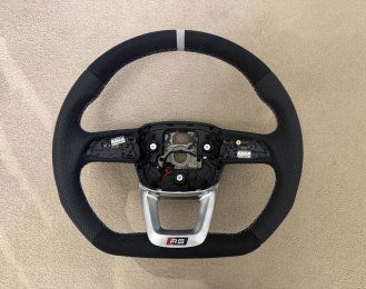

Sorted another annoyance with the RS4, the lack of flat bottom steering wheel. Always disliked the round, bus sized steering wheel. Also, because I'm a short a***, I have to have the seat quite high and the steering low, but then my legs keep snagging the wheel when getting in and out of the car (1st world problems).
This is actually my second attempt at this, I ordered the same wheel but without the grey band at the top, but bottled it when I realised the connections were different, but I just needed an adapter cable.
This is the original wheel - doesn't look very "RS" either:
IMG 2082
This is the replacement one with Alcantara at the top and bottom (can you spot the manufacturing flaw?). I replaced the lower chrome part with real Carbon Fibre:
IMG 2594 IMG 2610 IMG 2611

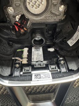

The new wheel needed some minor modification to allow the adapter harness to fit underneath the airbag. Other than that, it's plug and play.
Inside the original wheel, there is a "hand-off" module which is used for lane assist. The steering wheel has touch sensors all around the wheel and the replacement wheel didn't have space for this module or the wires to connect into it. It allows you to just touch the steering wheel instead of moving the wheel when it prompts you to put your hand on the wheel. My car doesn't have any form of lane assist so it was defunct in my case.

Feels better than the round one, looks miles better (IMO) and easier to get in and out of the car - still need to test the heated function.

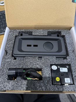

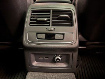

I have retrofitted rear USB ports. These are "dumb" USB ports which are only used for charging.
This is the kit I bought: https://www.aliexpress.com/item/100....order_list.order_list_main.24.75081802QLtMMM
I had ordered 2x USB-C ports (as you can see on the listing pics) but got sent 1x USB-C and 1x USB-A even though they don't have an option for that :shrug:. I'm taking this up with the seller, but will probably just keep what's been sent. The USB port unit is a genuine VAG part. It's used in a Skoda.
IMG 2808
It's very easy to fit - took me about 20 mins.
1762463816591

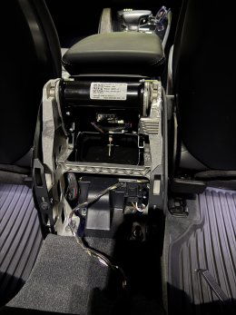

Move the front seats all the wat forward, then wedge a trim removal tool in the gap where the diagram shows the arrows (you might be able to pull it with your fingers), once the top is unclipped, pull the bottom off with your fingers (not much force was needed in my case). The assembly is sturdy so no danger of snapping it. Disconnect the 2 looms which go to the climate control panel, and one large connector to the 12v socket.

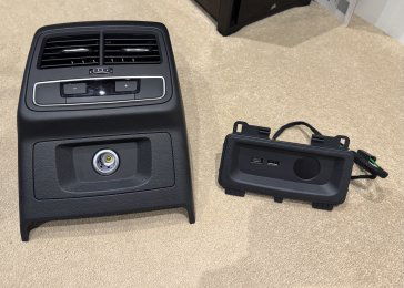

The 12v socket fascia unclips from the main assembly. The hardest part was removing the 12v Socket out of its original fascia. The clips are super tight, I used some plumbers pliers to get enough leverage to push the clips, in doing so, I have deformed the inner metal part of the socket so I need to sort that as its difficult to remove plugs from the socket.
You can get the USB fascia in glossy black, but where it is installed, I don't think it will fair well (will get kicked etc.) and my PPF applying skills are not good enough to wrap an awkward shape like that, so I opted for the standard finish. Some reviews said the colour was off, but mine matches quite well, looks OEM
IMG 2811
Installation is the reverse of removal. Arrange the cables in the lower section of the aperture (below the horizontal bar in the pic) Or the fascia won't got back on. The loom included in the kit piggy backs off the 12v socket power.
IMG 2810 IMG 2814
I thought the USB ports would light up, but it turns out, the 12v socket doesn't light up and neither does the one in the front...some more Audi peasantry going on because the pre-facelift 12v sockets light up (they lit up in my S3 too)...cheapskates!
My Car: IMG 2815 Pre-facelift:
1762465525354
