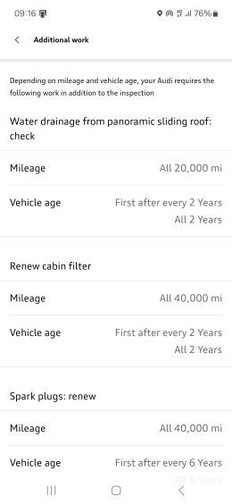

Just checked on the myAudi app, it's now showing as every 20,000 miles rather than the old 40,000 miles. Anyone know what's involved in checking this drainage thingys?
Screenshot 20250213 091648 myAudi
I think they use a sunroof drain cleaning rod like this but the sunroof servicing includes lubricating some of the mechanisms and I think "special" grease is needed.
Unrelated - If you have an iPhone, are you having any audio drop out issues when playing music via CarPlay? My MMI is on v3620 which is from 2021. I've got the dealer looking into this too.
I didn't know the sunroof even needed servicing so I didn't question it until I had this problem! I had a '99 Corsa with a sunroof and that never needed any "sunroof servicing"!
First of all have you got comfort closing on that car. It has come and gone over the years with changing legislation but on some cars, rain on the sensor will close the sunroof and windows (I have had one close the shade too on an older VW)
These pan sunroofs are quite complicated and need the correct lubricant. Squirting random stuff in it is known to cause issues. Correct stuff is called Krytox GPL (105 oil or 205 grease) not cheap but is anything for these cars?. Not difficult to do the service yourself, I give both of mine a good clean, including the drains and re-lubricate every year.

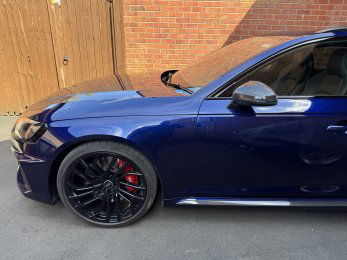

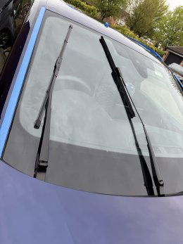

With the weather being a bit better at the weekend, I took the chance to sort the windows on the car. There was some water staining on the glass which left an effect like this when it was wet (not my pic):
1741002098328
You didn't really notice it when it was dry but visibility wasn't great when it was wet. I managed to get it off with some Gtechniq G4 Nanotech Glass Polish and then coated the side windows and pan roof with Gtechniq G5 water repellent coating. It sounds odd but the windows are much clearer from when looking through them from the inside.
It was hard work as the staining had been there for a while and each piece of glass needed polishing twice with a decent amount of pressure.
After being polished and coated:
1741002305621
I also repaired the lug I broke on the carbon mirror cap so its more sturdy now, polished the exhaust tips (total waste of time) and reduced one of the scratches on the rear bumper so its hardly noticeable now.
Next job is claying, paint correction and ceramic coating but this is a job for when the weather is a bit warmer to allow stuff to cure. It's going to be a tough job because the previous owner hasn't looked after it cosmetically. There are considerable scratches on every panel with some bad ones on the roof! I think the dealership put a polish with fillers on it when I went to look at it so the majority of the scratches were temporarily filled in.

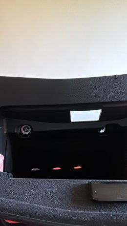

Another mod completed, added the drivers side storage compartment which is part of the storage pack. Someone was breaking a 2015 A4 on eBay with the compartment lid and tray that goes behind. Really easy to fit, only 3 bolts and some clips hold it in. Took me 10 mins to fit.
I didn't bother getting the proper screws from Audi for attaching the tray to the compartment lid. I had some M5x15 bolts from a TV bracket and some M5 washers so I used those, that aside, they're only like 50p each from Audi but I couldn't be bothered to go there. You can't see them anyway.

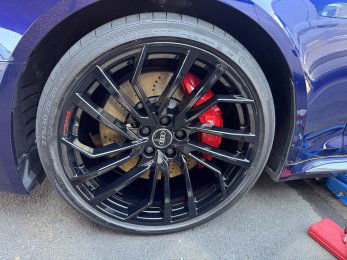

This weekend I ceramic coated the wheels, calipers and exhaust tips with Gtechniq C5 Wheel Armour.
Took ages because of the multi-spoke design of the wheels. 3 of the wheels have some light corrosion on the back of them but nothing too concerning. Most of the hairline scratches have come out of the wheels and hopefully I can reduce the number of contact washes on the wheels to avoid more scratches.

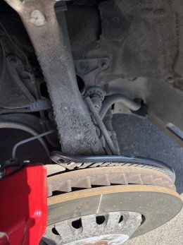

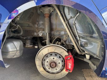

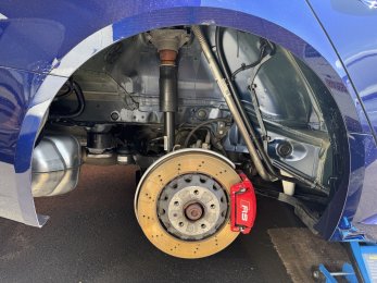

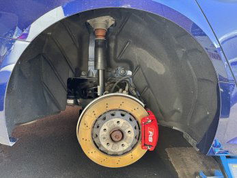

I also took the opportunity to remove the arch liners and clean behind them. Good job I did because where the front wings meet the door, there is like a box section which acts as a shelf and a small garden had accumulated on both sides, eventually it will rot the wing from the inside out. I must have removed a kilo of mud from both sides combined. I washed the arch liners too but didn't focus on these too much because they will get manky again immediately.
If you do clean this area (I recommend you do if you are going to keep your car long term), scrape out as much as you can whilst its dry, otherwise it shoots the mud into the door shut (and your face) if you try and blast it out - ask me how I know!
IMG 1413
Crud on the front suspension arms, there was a lot behind the brake disc too:
IMG 1410
Before pics of the rear arches:
IMG 1405 IMG 1406
After pics of the arches:
IMG 1408 IMG 1407
Wheels and calipers polished and coated:
IMG 1401 IMG 1396

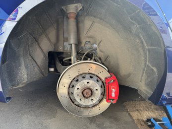

I too have identified the crap traps and need to clean them out, may be the liners too. I am not too fussy about the wheels as I had them ceramic coated when the bodywork was done. However you are correct in that cleaning the black gloss wheel surface does leave tell tale signs, so i just power wash them as up here they become filthy again in a very short distance.

Thanks!

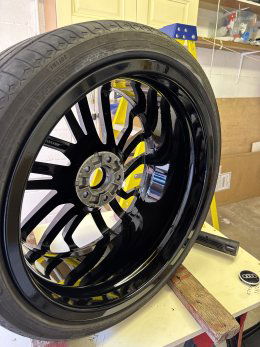

I'm actually not a big fan of the wheel colour or design. I feel black wheels lose all the detail and like you say, get dirty immediately after washing. I thought about doing a colour change (Anthracite/gun metal) or change wheels but I'm undecided on whether I will keep this car long term. Maybe the black will grow on me now they shouldn't be so bad to keep clean.
Which other crap traps have you identified? Your car seems new so I doubt you will have much inside your wings but it will be interesting to see if there is (keep us posted if you decide to clear them out). I wasn't expecting to find that inside the wing otherwise I would have got some waxoyl/Lanoguard or something to coat the inside but can always be done later as it's not a big job.
I use ACF50 on the RS3 every time the wheels get changed, on other stuff that gets more of a beating I use a few different flavours of Dynax, bit thicker and sticks better but doesn't penetrate like the ACF50. I use a small portable compressor and cheap supermarket spray gun works a treat.:icon thumright:
Just don't spray ACF50 anywhere you walk or you'll end up on your a$$ worse than boiler plate ice. Aske me how I know :tearsofjoy:
