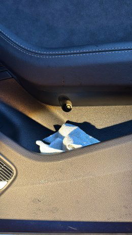

Fitted some proper door warning lights replacing the reflectors in the door.
Very easy to fit (and reversible), remove the T25 screw that is in the middle of the door card, and pop the clips at the bottom of the door with a trim removal tool. The clips just push back on afterwards. You could fish the wire through but I think it would take longer. This took 5 mins per door.
The loom that came with the kit piggybacks off the puddle light so no need to faff with soldering or connecting to the door modules, it's plug and play. It was only £15 with genuine VAG connectors and light units.
The process and kit is the same for the A5.
Remove this screw in the door card:
16B2FB74 2AD6 4DBD 8C12 C4FA39E72B2888
Before:
After:

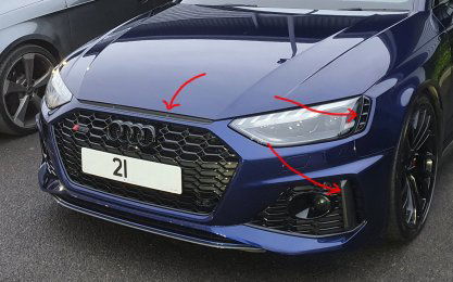

Decided to de-chrome the lights with some black vinyl I had lying around. Never understood why Audi left the tail lights with the chrome strip on black edition A4's and it looks weird with the black strip that is on the boot lid. Probably more cost cutting.
If you look around the lights you can see a marker around the chrome bit. I measured this marker (use a tailors tape measure as it's more flexible), cleaned the lights with IPA, cut and stick the vinyl.
To do it properly you would need to open the lights but I didn't want to get into that can of worms.
Before: View attachment IMG_0366.jpg
After: View attachment IMG_0369.jpg

I've recently bought an RS4, remarkably similar to the one at the top of this thread. 21 plate, Navarra Blue, Carbon Black. Main difference is I have the white interior. Since you guys mentioned carbon bits, I'm wondering if anyone's been able to do anything with this piece that shows at the end of the bonnet on the B9.5. On my Carbon Black edition it feels like that piece should be either Carbon or Black (like the other two bits I've arrowed). I feel it'd look a lot smarter if it were carbon like the other accents around the front. Searching for carbon parts on the internet gets me plenty of other trims, skirts and other bits, but I wouldn't know what to even call that part!
Congrats on the purchase. Sorry can't help, but if you can take it off, could you wrap it?
Congrats on the motor!
The bottom grilles on the carbon black should already be in carbon fibre so if you don’t have them, then you can definitely purchase those (won’t be cheap). If you don’t have them I can take a picture of mine when I get it back from the dealer (panoramic roof is leaking).
I haven’t seen carbon options for the other parts. If you can get them off you could look into getting them hydrodipped. Wrapping is an option as mentioned but they look like awkward pieces to wrap
Sorry to hear panoramic is leaking. Let us know how you get on once dealer hopefully resolves. It’s well documented on B8 platform, but didn’t realise B9 suffered too, and on a 21 plate. Hopefully nothing more than blocked drainage channel.
It probably is a blocked drain but when I wash the car or it rains heavily, the sun shade for the roof will close so water is getting to the switch/light unit and I can see soapy water marks on the inside of the windscreen from when I washed it - I originally thought the windscreen was leaking as it has been replaced before my ownership.
I could have cleared the blockage (if it is that), but with the roof/light switch acting funny I wanted Audi to fix it.
I bought the car with 40,500m on the clock, AFAIK the sunroof should be serviced every 40k and I was told that if an approved used Audi needs something within 6 months it being sold to the customer, the dealer will resolve it before it's handed over.
I didn't know the sunroof even needed servicing so I didn't question it until I had this problem! I had a '99 Corsa with a sunroof and that never needed any "sunroof servicing"!
I dont know how long it's been leaking for and what damage there is that I can't see. Fortunately the car is garaged most of the time when it's at home and if it's not, it's under the car port.
