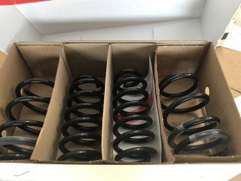

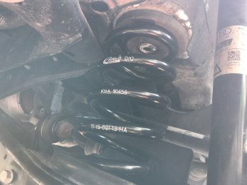

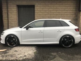

I’ve done tonnes of mag ride calibrations on RS3’s over the years, standard and modified cars, always have had great feedback from owners.
I’ve never understood the love for the vastly Overpriced MSS spring kit though, at the end of the it’s a Eibach spring and they do a nice standard 10-15 version for a few hundred quid vs crazy MSS costs.
My FL was lowered a little on the Eibachs with the 034 rear swaybar.
IMG 2825IMG 2738IMG 2557
I think the issue is that if you don't want to lower the car there is not many options out there, but I get what you are saying, they are Eibach springs and some fancy plastic spring perches. If they had double springs at the front I would say there might be some advantage but they don't.
I don't want my car any nearer the ground and I am struggling to see an alternative other than different OEM springs from a magride S3

Once that's done, I am hoping to sort the suspension out. As I've said before, the combination of MagRide shocks and MSS Track springs is very good on smooth roads - but I am looking to raise the ride height so that I can take on unknown roads with more confidence. I'll probably do this by refitting the standard springs as the outcome will be a known quantity to me (last car had standard springs on MagRide).
1759955279585
As you can see in the photo above, I've had the standard springs refitted and restored the car's chrome badges. Here it's still missing the chrome "RS3" logos but I have since refitted these, as well as adding some colour coded mirrors instead of the OEM upgraded carbon weave ones. Cosmetically, the car is now as vanilla as they come and it's definitely more my style.
The OEM springs with new top mounts are a total revelation. While the MSS adjustable double-stacked springs with fancy top mounts seemed to offer an initially good ride, they meant the car was seriously compromised on undulating roads to the point where it was too specialised for my needs. By comparison, the standard setup (with re-tuned Magride adjustable shocks) is a chasm level upgrade in comfort and usability especially on unpredictable roads.
That is what I try to keep telling people who ditch MagRide at the first problem. Get it calibrated and working well first then decide.
I did go a step further and am running a DSC controller. At least now I can calibrate it myself now and tweak things as needed.
Reactions: Karbonfaiba
Thanks @Karbonfaiba - the car's booked in with MRC next week to be tuned around the OEM spec HPFP. I will only be driving it up to them, and - as you advise - no WOT.
@flybynite The MagRide was apparently recalibrated when the MSS springs were fitted, but even so it lacked a substantial amount of travel. Now with another c.50mm front and 35mm rear the suspension movement range is far greater. I guess I could have wound up the MSS springs as they had adjustable travel but at least with OEM I knew what the outcome would be.
