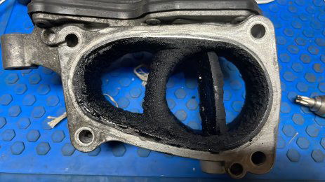

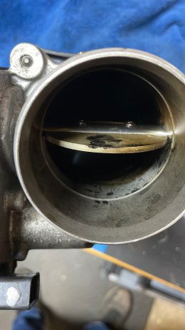

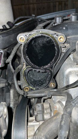

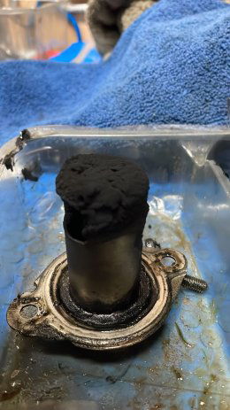

Just an update. This evening I removed the swirl valve and back to the butterfly to see if they were bunged up or seized. Not too bad but cleaned out anyway. See what tomorrow’s cold start brings.
I’ve seen worse a lot worse on YouTube so I don’t think there’s are too bad?
