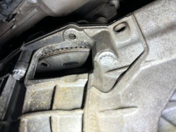

Good afternoon,
2016 Audi A6 Avant (C7) 2.0 TDI SE Executive
New member, first time poster! A real newbie question just to get warmed up.
Please see attached photo from the bottom of my transmission casing.
Is that the flywheel I can see through the port, should this have a cover over it?
Thank you in advance,
Kind regards,
Yes that’s it. I would say that’s an inspection window so should be a plastic cover.
PM me your reg or vin and I can have a look on the parts diagram and see if there should be one.
Reactions: LukeKirby
Thanks Darren, that would be awesome, will PM you now
Thanks Darren, appreciate the help

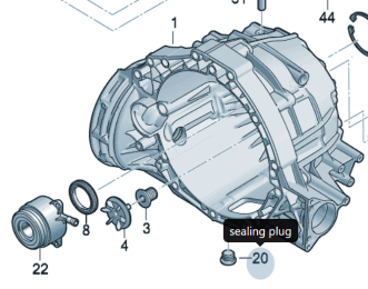

8K0 301 257 A
Transmission Housing Cover
