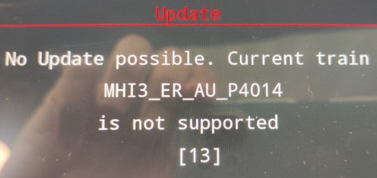

This is another file, because size is 9,67GB
Please, don't update to 4014 if you can go directly to 4398.
This error appears to me if I try to update from 4014 to 4398.
Maybe I can solve it with modified some metadata, but I need help.

Just been trying it now mate, but both the MHI3_ER_AU_P4364 and MHI3_ER_AU_P4398 aren't recognised. Both have "Data" and "Meta" folders, but no index or metadata file in the root. I don't know if that's actually needed, but feels like it might be?
I think is your USB device.
Tray again with 4398 but USB formatted as FAT32!
Format the drive with FAT32 and decompress again like your previous photo.
Any news about the update?
4398 installed...
