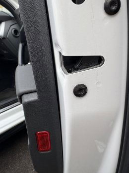

My left door has started rattling again with punchy bass (was previously in at Audi where they insulated the doors and it was a lot better) but suddenly it’s rattling in the far left corner near the door catch area, it stops when I hold the bit of door card so I know where it is this time at least. I’m a bit worried how it’s been fine since and only started rattling again, surely the sound deadening they put in last time wouldn’t come loose? It’s this bit that the rattle is coming from but the other door. Annoying that I’m going to have to need to book it in at Audi again
