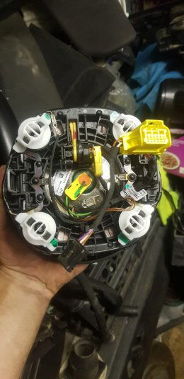

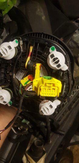

Hi, here is a picture of the airbag.

Hi Rob, Not afraid of do modifications, just need to no what to do?? The wheel will fit fine, but the B7 Airbag connector on the clockspring will not
accept the B8 airbag plug.
