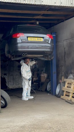

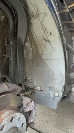

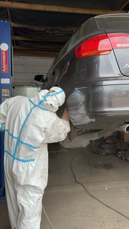

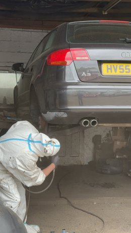

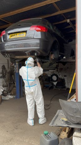

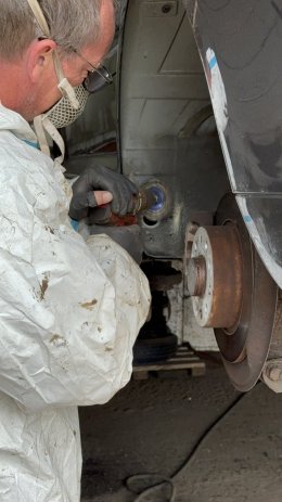

when i spoke to Mike about Waxoyl on new cars, he said there are customers who want such protection on brand new cars. Many new van and truck owners (company owners or individuals) keep Mike busy with Waxoyl contracts. When i had my 19 year old A3 waxoyled, it was the first time the wheel arches came off since probably factory and everything was cleaned, the surface rust removed and waxoyl applied. Lots of cob webs, leaves, mud, spider webs and 1 spider under the wheel arches. :glee::glee: see pictures attached
