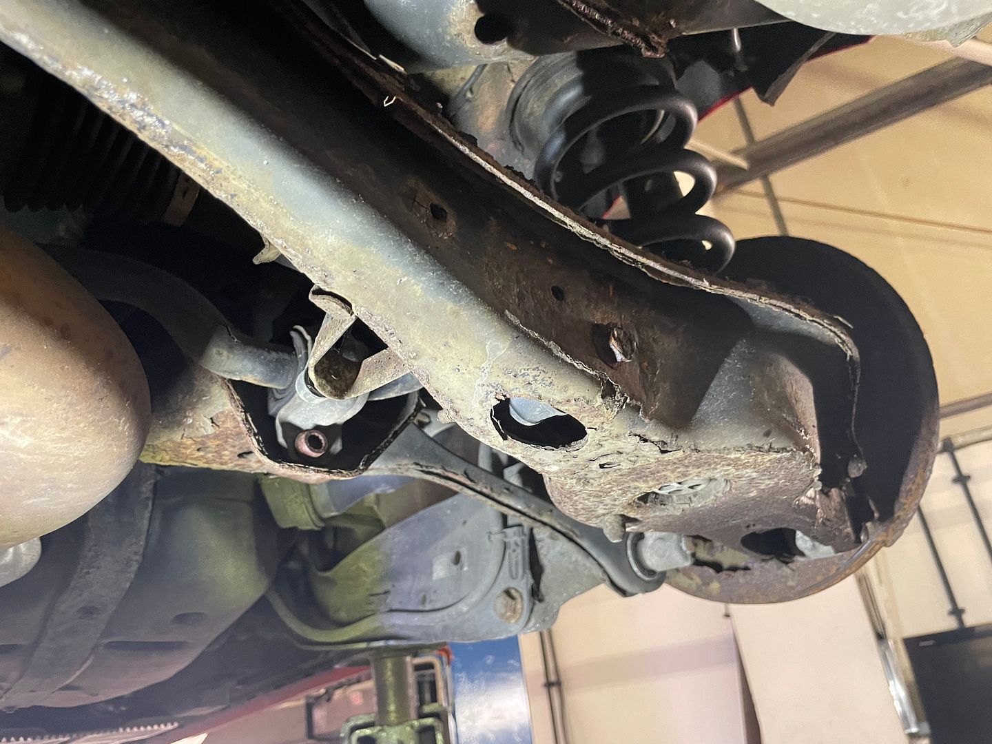

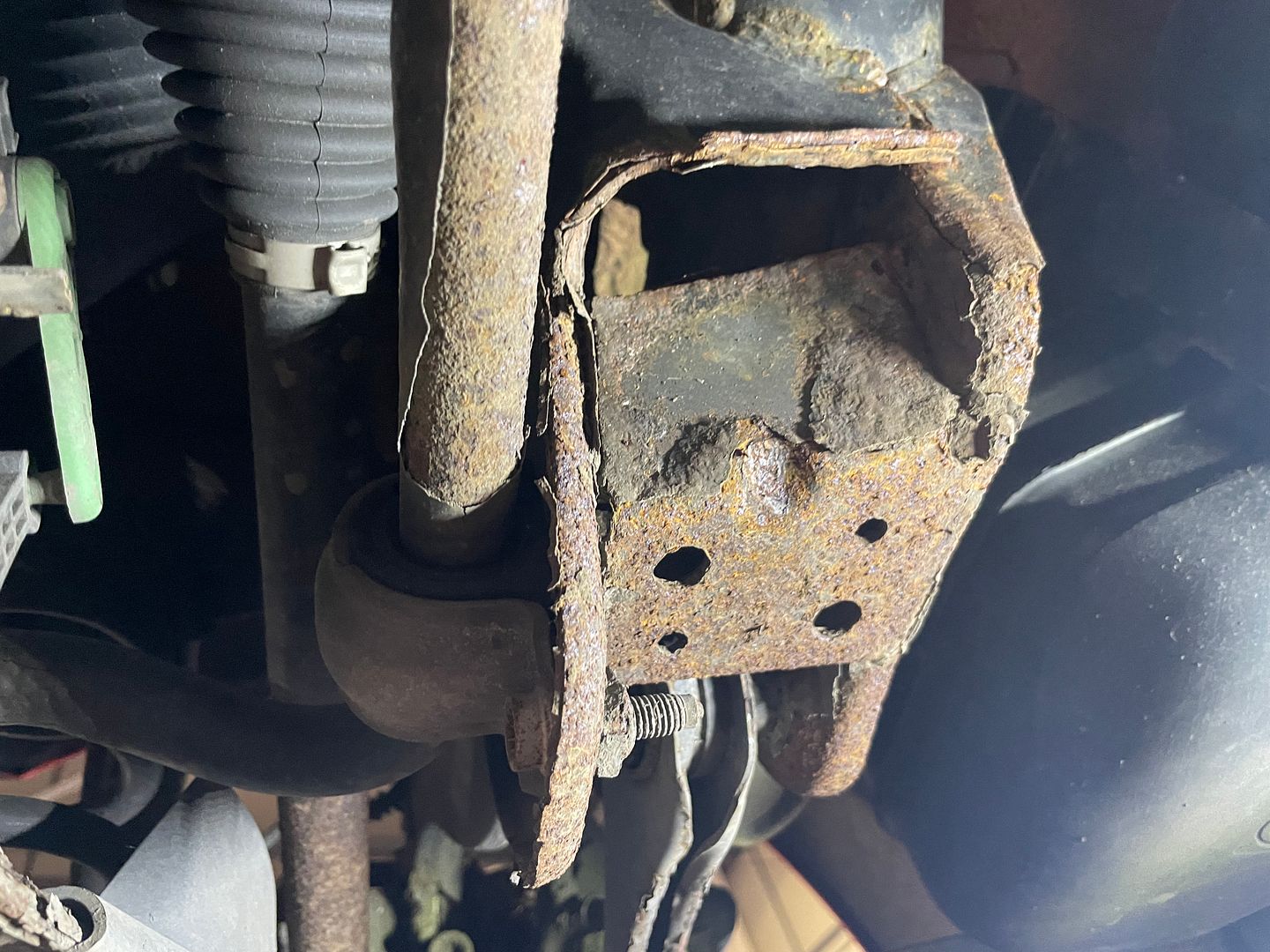

The latest issue is that the rear sub frames have really detreated. I knew there were some surface rust on them but now it has gotten bad it was more than flakes of paint coming off. It would be a sensible to replace them with new ones as the bushings looked worn out as well.
So hoping it will be ready to be put through the MOT at the end of February.
