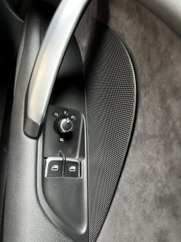

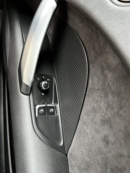

TT MK3 door trim falling out, clips look in tact but won’t hold, any ideas?
Pull of, bend clips very slowly so they're more outward leaning, then refit, probably just this, if still not right, remove card, then refit the grill on a bench or the like, if need be used some epoxy to hold in place, don't use superglue as it will make the grey dark areas of the grill white & it spreads outwards & may show on the front part.
Reactions: samsmith
I’ll give this a try now, thank you
